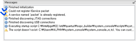

Warning Msg in system console "could not resgister IService packet"
- 3 years ago
Those warnings probably are not the root cause. I encountered same warnings as well but don't have problem at performing system console check image below.
I follow the tcl script (main.tcl) attached below for your reference in this example design https://www.intel.com/content/www/us/en/docs/programmable/683758/21-3-19-2-0/hardware-test-for-system-console-control.html
Make sure you have correct $master_index. May be can try to run simple commands below to check whether the problem still exist:
