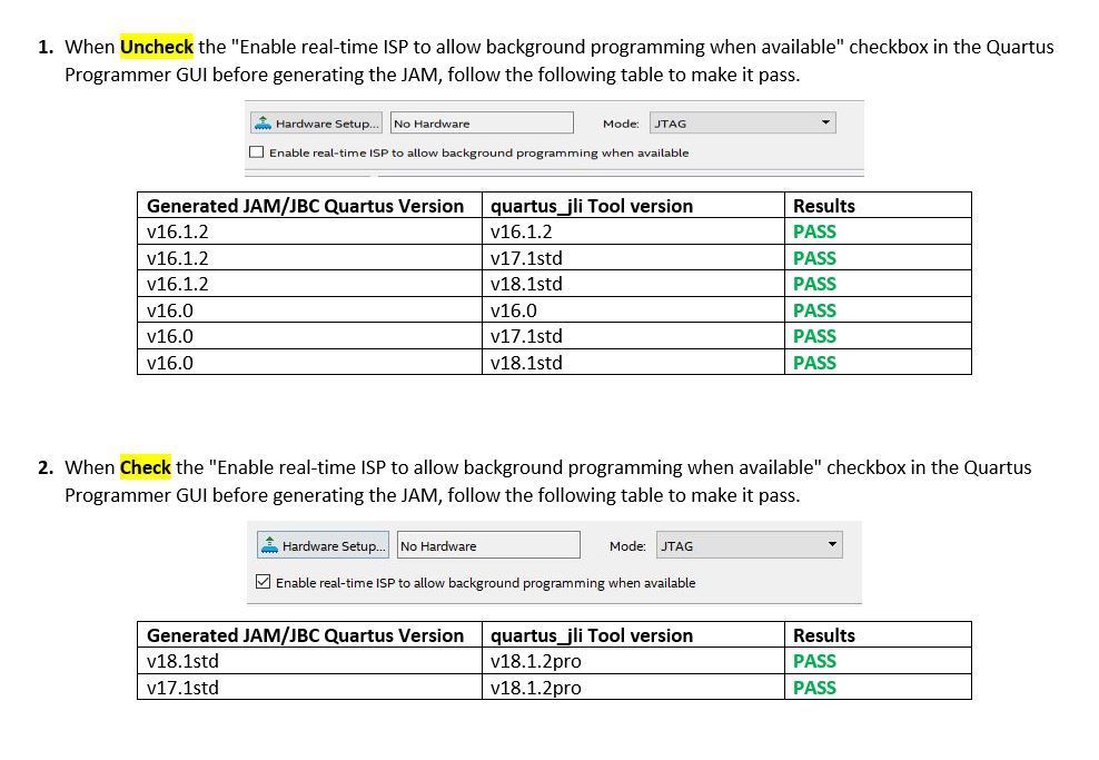

Hi MStof1,
Maybe you can try this workaround. Please refer below:
Cheers.

Hi MStof1,
Have you tried to TICK/UNTICK this option? Any different in your design?
Cheers

- ShafiqY_Intel
Hi MStof1,
Kindly try it out with your design first and let me know the result.
