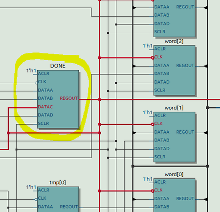

2 years agoVery slow clock should be constraint as false path?
Hi there Ive just created project in which 1200bps rs232 data is sampled and then loaded into 8 paralel registers to leds. All registers but the final latch are driven by 50MHz board, but set clk_en...
- 2 years ago
The problem is that you are using DONE as a clock signal. It's not. You should just create combinatorial logic or better yet synchronize the loading of word with clk.
always @(negedge clk) begin if (reset) begin word<=0; end else if (DONE && clk_enable) begin word<=tmp[7:0]; end end
sstrell
2 years agoYou may be able to get away with false pathing it, but how is it coded?
