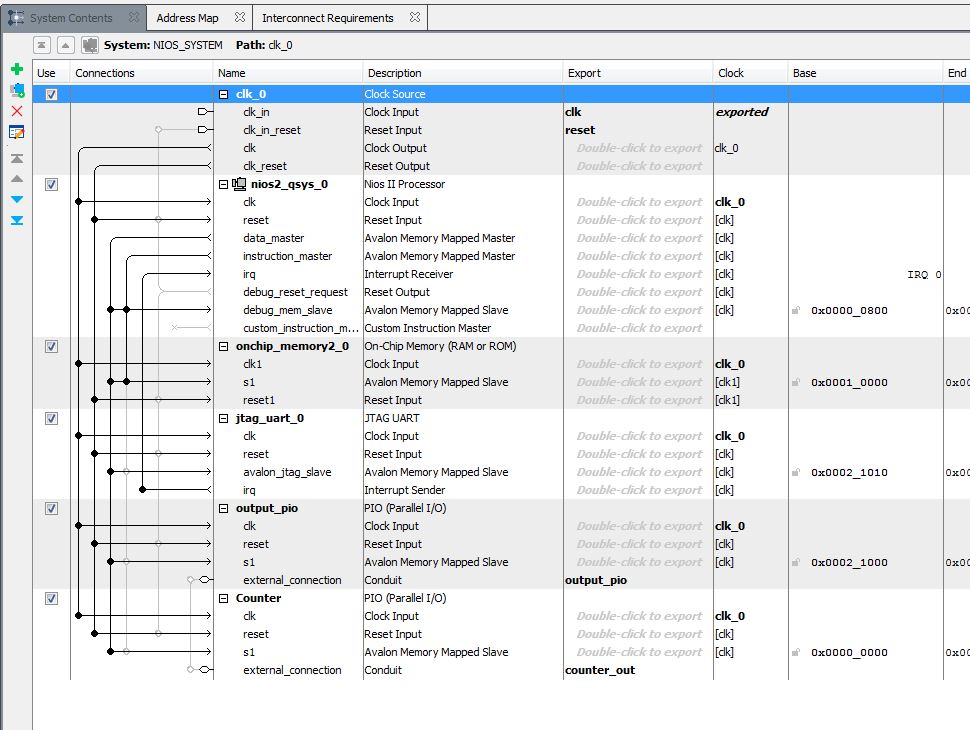

I am trying to read and write 8-bit Counter data Using Quartus and NIOS.
In SOPC : I am assigning PIO : 1-bit input for enable
PIO : 8-bit output for out

module Counter_Top_Level_design ( input clk, output reg[7:0] out ); always @(posedge clk) begin out <= out + 1; end NIOS_SYSTEM niosii_system_inst ( .clk_clk (clk ), // clk.clk .reset_reset_n (rst_n ), // reset.reset_n .counter_out_export (out) ); endmoduleI have assigned PIO (output):8 bit, its showing error. If i assign PIO (input):8 bit error not coming. But i want to read the counter data.

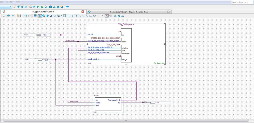

Hello, Instead of PIO. Now i am using AVALON On-chip FIFO Memory Core.
Still my issue have not solved. Please help me 😨
I am getting Proper answer
- SS5
Sorry, I am not getting the result.
