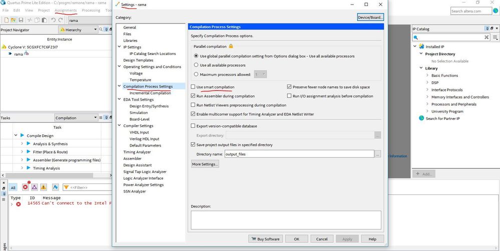

To turn on smart compilation, on the Assignments menu, click Settings. In the Category list, select Compilation Process Settings and turn on Use smart compilation.
https://www.intel.com/content/dam/www/programmable/us/en/pdfs/literature/hb/qts/qts_qii52022.pdf
please let me know if you have any different concern & refer below screenshot,

My observation is it is not supported for the MAX series devices as they are 'too small' for it to matter. Cyclone and up devices support the feature. YMMV.

I believe it`s device dependent but there is no enough information available for devices support details except Arria 10 devices are not supported(Quartus Pro User guide).
https://www.intel.com/content/www/us/en/programmable/quartushelp/current/index.htm#msgs/msgs/wflow_smart_recompile_disabled_for_current_family.htm
