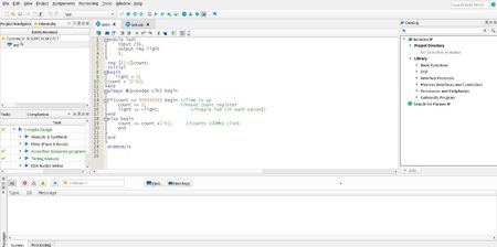

We are using a custom board, Cyclone V development board Version 2. The Quartus Prime version we are using is Quartus Prime Lite Edition 22.1.

We have followed these steps to create a New project wizard. Kindly let me know if this is correct.
1.
2. Ours is a custom board. Which is the board option we should choose in this? Or is there a way to add the board version at this stage?

These are the programming steps followed:
1. USB Blaster cable is detected
2. When auto-detect is pressed, the device is selected
3. This error appears after the program is tried to be dumped.
Are the steps of programming correct? Am I missing out on anything?
As mentioned, no LEDs or push switches are on the custom board. One GPIO pin was set as the output pin, and an LED was connected. The pin is given an I/O standard of 3.3V - LVTTL, with a current strength of 16mA. As I understand, LED requires a 20mA drive current. Is this probably the issue of why the LEDs aren't turning on?
Is there a solution for this?
