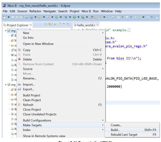

Right-click on eclipse project tool and click Make Targets -> Build as shown in Figure. Select mem_init_generate and click Build to generate the HEX file.

Does it have to be eclipse? I have been using either Quartus lite version
>>Yes, Open Quartus ->tools-> click on nios ii software build tools for eclipse
