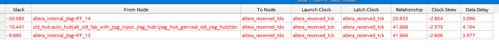

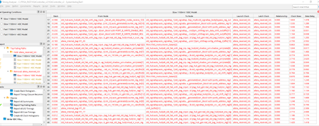

@sstrell I just tried removing all tck references in my .sdc file. That is still giving me the same altera_reserved_tck complaints:
I can't remember how the tck entries were put into the .sdc file. I was following some help on adding constraints and I either clicked on "Create Clock" or "Generate Clock" in the Timing Analyzer.
Whereabouts would I find the JTAG constraints template that you refer to? Are you referring to the likes of this:

@sstrell By pasting in the JTAG template that I found, the tck errors seem to be less:
..but they are still present. I just left the "--customize here--" sections as the defaults.
Is there something else I need to do to get rid of these?
I also re-enabled the SignalTap instance and I now only have the same 3 lines above - so it does look better.

module SystemVerilogTest1( input logic sw1, input logic clk, output logic clkFast ); logic tck, tdi, tdo, cdr, eldr, e2dr, pdr; logic sdr, udr, uir, cir, e1dr, bypass_reg; logic [3:0] ir_in; logic [3:0] ir_in_copy; logic ir_out; vJTAG v( .tdo (tdo), .tck (tck), .tdi (tdi), .ir_in(ir_in), .ir_out(ir_out), .virtual_state_cdr (cdr), .virtual_state_e1dr(e1dr), .virtual_state_e2dr(e2dr), .virtual_state_pdr (pdr), .virtual_state_sdr (sdr), .virtual_state_udr (udr), .virtual_state_uir (uir), .virtual_state_cir (cir) ); always_ff @ (posedge tck) begin end Clock100 clock100( .inclk0( clk ), .c0( clkFast ) ); always_ff @( posedge clkFast ) begin end endmoduleI still have the below problems:
I have attached my .sdc file too. I must have something wrong in the .sdc file surely?
