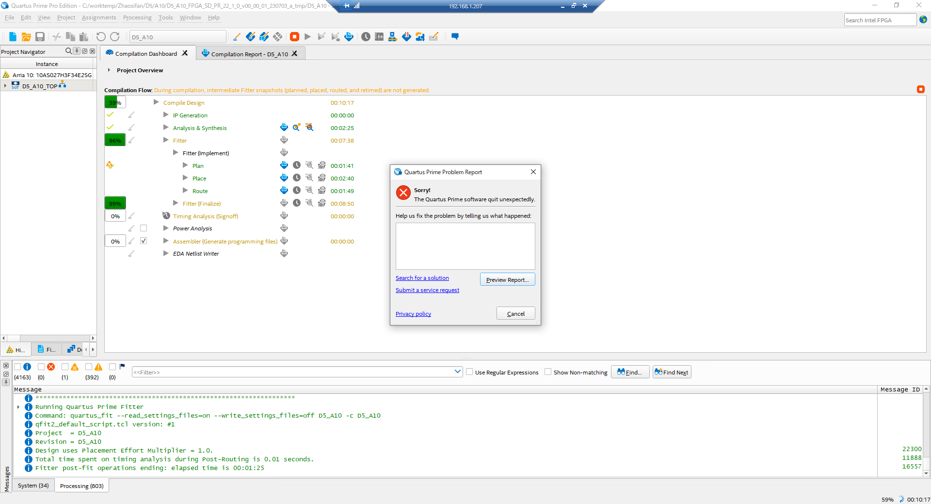

Hi
I got Quartus prime Problem report during compilation - I got pop up message and then the Quartus stuck
The problem details are :
Problem Details
Error:
Internal Error: Sub-system: FDRGN, File: /quartus/fitter/fdrgn/fdrgn_expert.cpp, Line: 5351
Final postfit netlist check failed
Stack Trace:
Quartus 0x93ce8: FDRGN_EXPERT::check_and_report + 0x568 (fitter_fdrgn)
Quartus 0x20ea5: fit2_write_fitter_report + 0x1b5 (comp_fit2)
Quartus 0x16442: TclNRRunCallbacks + 0x62 (tcl86)
Quartus 0x17c4d: TclEvalEx + 0x9ed (tcl86)
Quartus 0xa6a8b: Tcl_FSEvalFileEx + 0x22b (tcl86)
Quartus 0xa5136: Tcl_EvalFile + 0x36 (tcl86)
Quartus 0x22260: qexe_evaluate_tcl_script + 0x640 (comp_qexe)
Quartus 0x20e0f: qexe_do_tcl + 0x8df (comp_qexe)
Quartus 0x29d91: qexe_run_tcl_option + 0x701 (comp_qexe)
Quartus 0x28d0f: QCU::DETAIL::intialise_qhd_and_run_qexe + 0x10f (comp_qcu)
Quartus 0x3804e: qcu_run_tcl_option + 0x76e (comp_qcu)
Quartus 0x2951c: qexe_run + 0x48c (comp_qexe)
Quartus 0x2a84a: qexe_standard_main + 0x26a (comp_qexe)
Quartus 0xbba2: qfit2_main + 0x82 (quartus_fit)
Quartus 0x1db28: msg_main_thread + 0x18 (CCL_MSG)
Quartus 0x1e312: msg_thread_wrapper + 0x82 (CCL_MSG)
Quartus 0x2a313: mem_thread_wrapper + 0x73 (ccl_mem)
Quartus 0x1b048: msg_exe_main + 0x178 (CCL_MSG)
Quartus 0xcd1f: __scrt_common_main_seh + 0x10b (quartus_fit)
Quartus 0x17613: BaseThreadInitThunk + 0x13 (KERNEL32)
Quartus 0x526f0: RtlUserThreadStart + 0x20 (ntdll)
End-trace
Executable: qpro
Comment:
None
System Information
Platform: windows64
OS name: Windows 10
OS version: 10.0
Quartus Prime Information
Address bits: 64
Version: 22.1.0
Build: 174
Edition: Pro Edition
Do someone know how can I solve it ?
