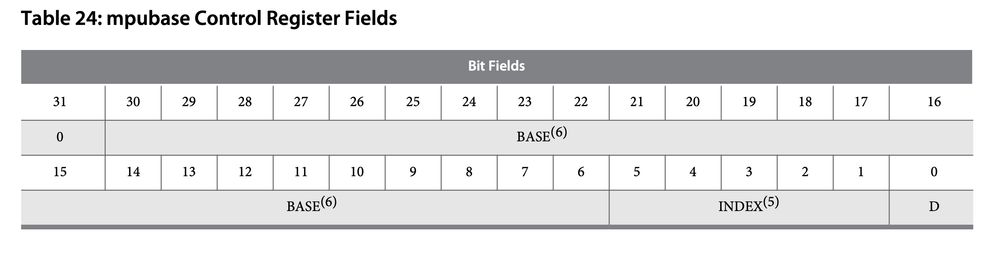

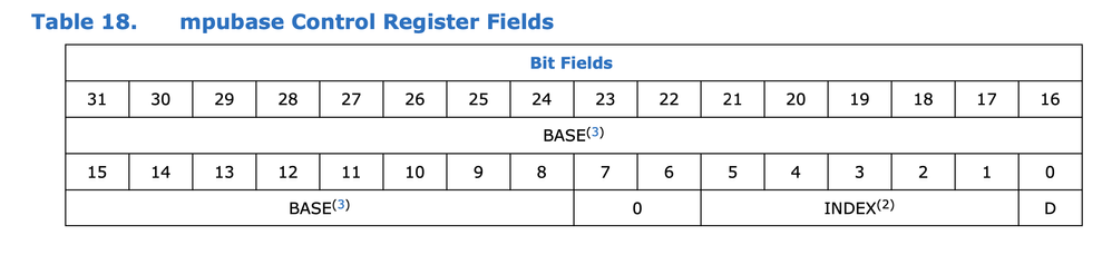

Example of old mpubase register 
Example of new mpubase register

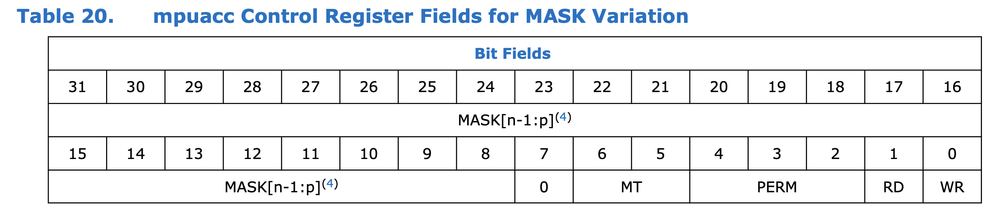

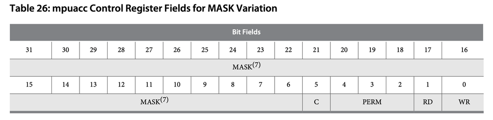

Example of old mpuacc register
Example of new mpuacc register
So it appears that these registers were updated in the IP, but not in the BSP and so if you try to use the examples in AN540 (which the embedded design handbook still refers to), they won't work. You'll need to either update the register definitions in nios2.h or instead, edit mpu_utils.c and mpu_utils.h in order to get it to work. I chose to edit the mpu_utils files as these are not part of the BSP and thus won't revert back after regenerating the BSP.
I've attached the edit files here.
