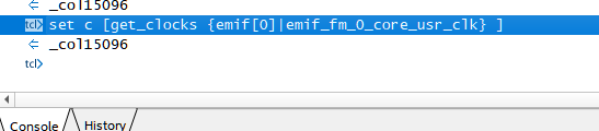

I am not able to run stand alone tcl commands from timing analyzer gui.
Please can you tell me what am I doing wrong?
what does _col15096 mean? More meaningful error will be helpful.
I tried to list of available packages but I got this error.
Does the tool allow running stand alone commands from the tcl console inside the timing analyzer gui?

    The Tcl console in the timing analyzer only supports direct SDC and reporting commands. Anything beyond that, you would use the Tcl console in the main Quartus software. Maybe it would let you load additional Tcl API packages, but I've never tried that.
