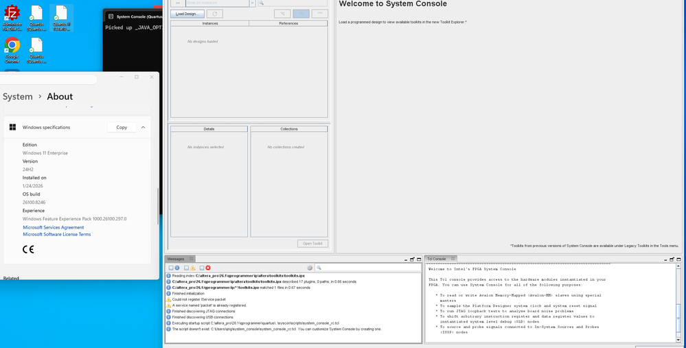

I test and there's no problem for my site check:
I would suggest try to uninstall and re-install. Before re-installing, make sure turn off any suspicious software like anti-virus, anti malware or vpn
