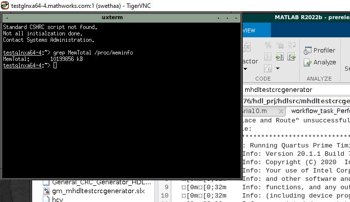

RAM specification of debian 11 machine was 10GB while max peak virtual memory occupied in the session was 3GB.
Attached the place and route, matlab command window log and device RAM specification
The same features were running fine in debian 10 machines.
What is the Required RAM specification for deb 11 and 20.1.1 version?
