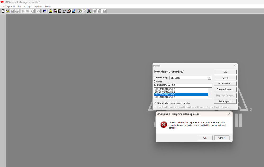

        Thanks ever so much for the Link, and I have just installed the software, and I am really eager to get back into it after all these years.
        But, I am now having an issue with the license as you can seen in the attached image: This license is not allowing me to use the device I have. Any advice on how I can get around this obstacle, please?
        Victor

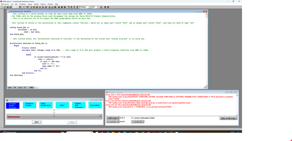

      After my joy of installing MAX+PLUS II, now I am starting to use it again, and am getting these 3 Syntax errors that I do not understand. After verifying it a number of times and still not spotting what the problem is, could anyone, please, help by examining the attached, please? I'll be really grateful if anyone could spot where I am going wrong. Just to add that I first wrote this same module module/component about 25 years and it had worked then.
      Many thanks for your invaluable help.
      Victor

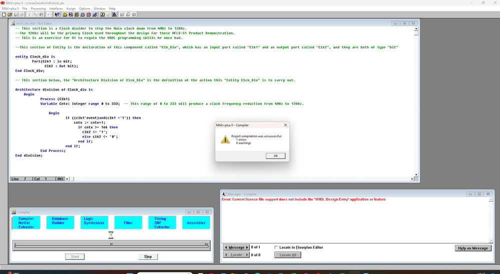

        Hi All,
        I think I spotted what the problem with my Syntax error may have been: "File naming".
        Now that I corrected that, it appears that the License I was given does not support VHDL as shown in the attached. Please, help !!!
        Thank you
        Victor
  • Hi,
    FLEX 81500AQC240-2 was obsolete long time ago and no longer supported Quartus. No license is available for the device.
    We have very limited resource for obsolete device. Hence sorry to tell you that we are unable to support this request. I will close this case.
    Aiman
