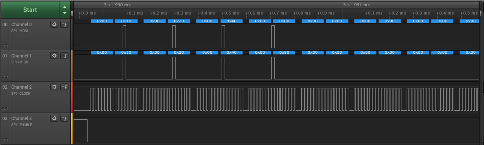

I'm having an issue with the SPI port sending out 16 clock cycles every time I try and write a single byte using a NIOS2f.

I see the attached on my logic anaylzer.

I was able to figure out this problem.
It was because Quartus was not regenerating the design files for the IP cores when compiling. So even though my NIOS thought it was writing 8 bits to the SPI IP, the SPI registers were still 16 bits wide.
To fix it, I opened the project in quartus, went to tools > options > IP settings and checked the radio button next to Always regenerate design files for IP cores.
