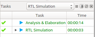

I have Quartus Prime Lite 19.1. Here is what happens when I start RTL simulation.
