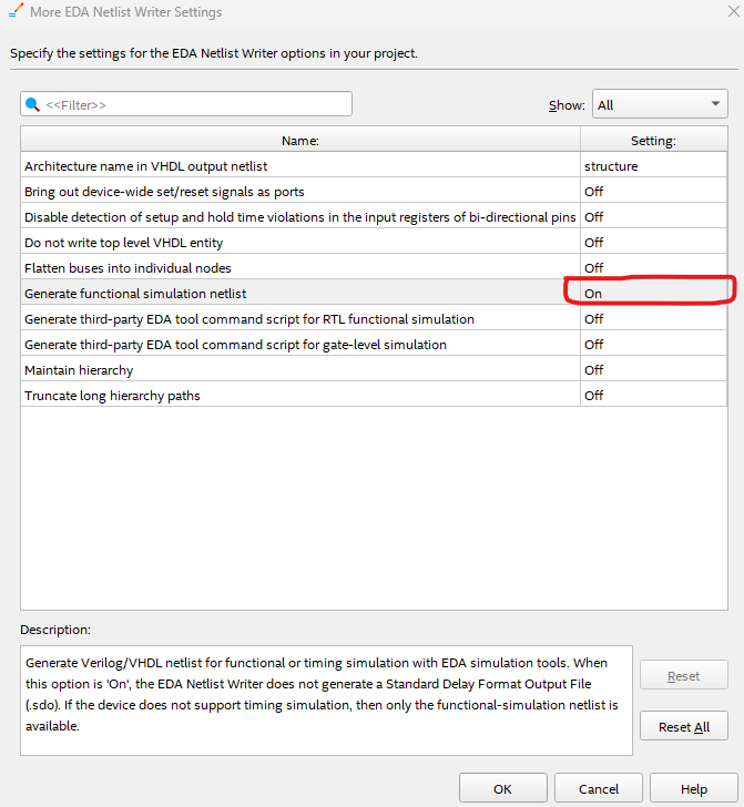

Through this error code, I can't point out what specific problems occurred, but here is what I tried to do.
1. romove
-novopt
in "simulation options" in the Simulation Waveform Editor
2. "simulation options" in the Simulation Waveform Editor and change
vsim -novopt
to
vsim -voptargs="+acc".
3. make sure I have a specific EDA tool in my settings(All the tools have been tried but have the same error code,so I guess it's not the tool's problem)
Am I missing something?
