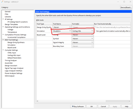

Simulation Waveform Editor error after upgrading to version 22.1std
- 3 years ago
Windows 11 is not a supported OS for Quartus 22.1std.
Windows 11 is only supported in Quartus 22.3Pro onwards, which is why you see this issue.
Please use Windows 10 for Quartus 22.1std. Let me know if you see any issues with this.
Nurina
Nurina
- TTTong3 years ago
Late reply for a few days, originally did not consider let the OS back to win10,so spent a little time on version 22.3, but I didn't expect more problems in this situation haha,
finally decided to return to win10 after using version 22.1 and it works!
thank you so much for your advice!
