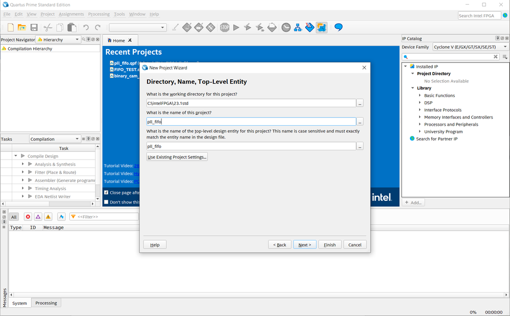

  • Create a new Quartus Project (.qpf)
    1. File -> New -> New Quartus Prime Project
    2. [Introduction] Next
    3. [Directory, Name, Top-Level Entity] Pick file location, name project/top-level entity something descriptive
  1. [Project Type] Empty
  2. [Add Files] Next

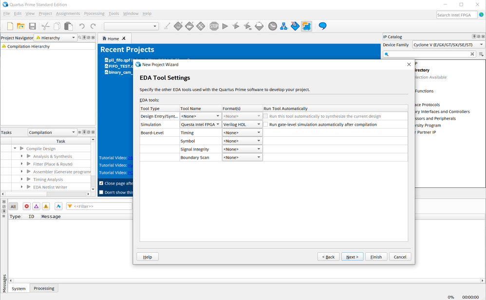

  3. [Family, Device, & Board Settings] Choose accordingly, I left as default (as there is no physical FPGA I am using for this simulation)
  4. [EDA Tool Settings] Choose Questa Intel FPGA for Simulation tab and either Verilog or VHDL accordingly for the format
  1. [Summary] Finish

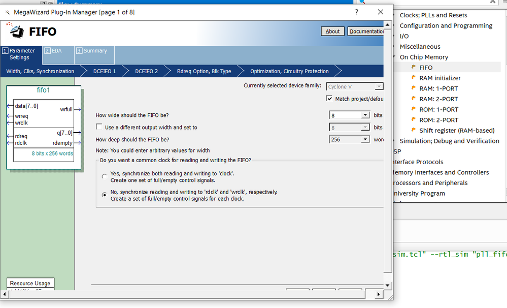

  3. Under [IP Catalog] on the right side, select Library -> Basic Functions -> On Chip Memory | Then double click FIFO | Give the FIFO a name, in my case I named it, “my_fifo” | click OK
  1. Under the common clock setting, select No -> Next

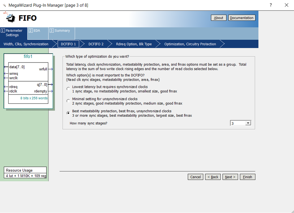

  1. Under DCFIFO 1, select Best metastability protection -> 3 sync stages -> Next

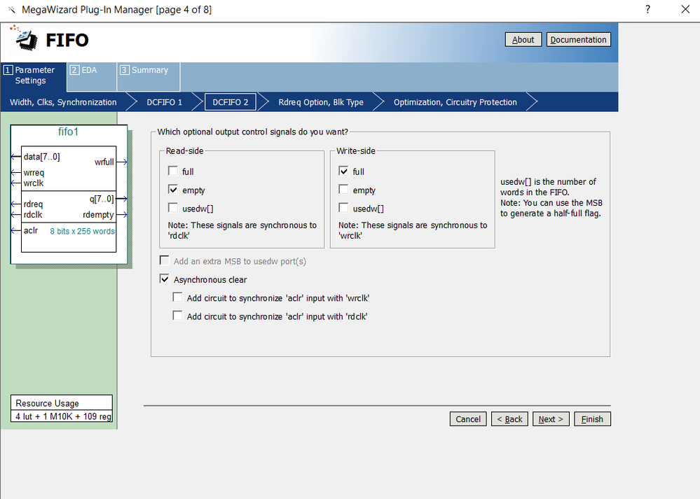

  1. Under DCFIFO 2, select Asynchronous clear -> Next

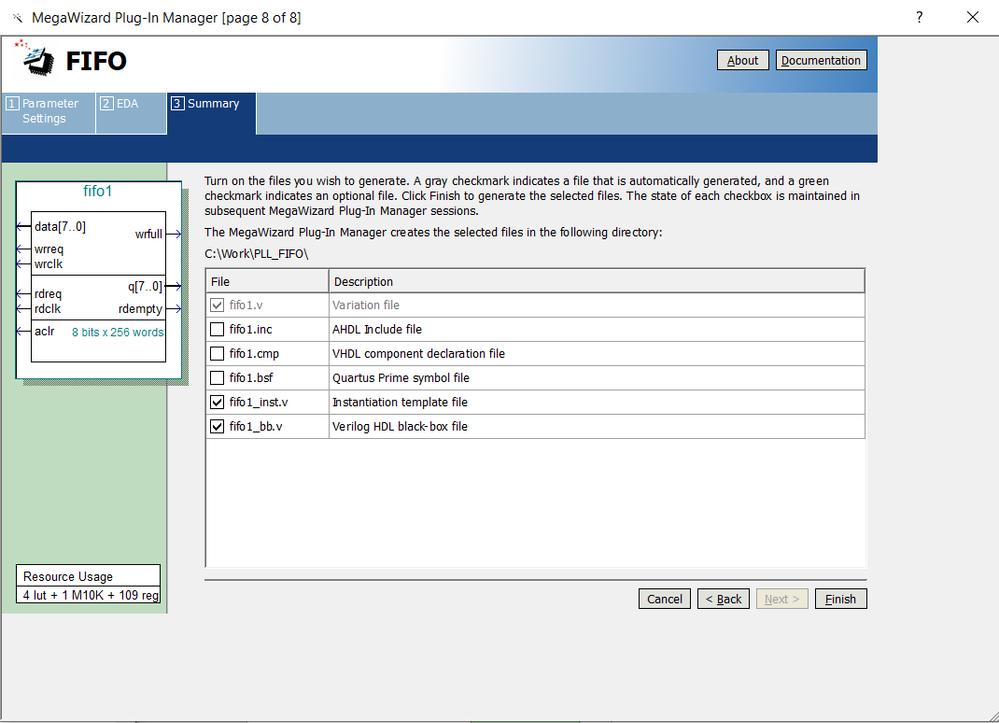

  1. For the next few prompts, leave as default until [Summary], where you select Instantiation Template File -> Finish
  2. As with the PLL, you will be prompted to add the files to the project where you will select Yes

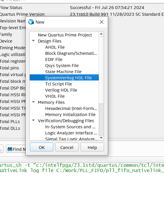

    1. Click File -> New -> SystemVerilog HDL File -> OK
  1. Input the following code and save as “top.sv”:

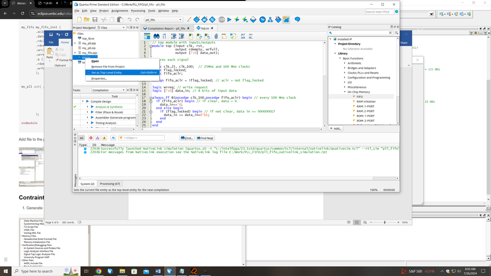

  1. Add the file to the project and set it as the top entity by right clicking on top.sv under Project Navigator (you may have to switch to the files tab) and selecting “Set as Top-Level Entity”

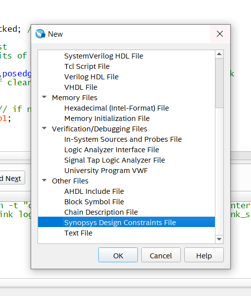

  • Creating a Constraints File
    1. Select File -> New -> Synopsys Design Constraints File
  1. Insert the following code and save as top.sdc:

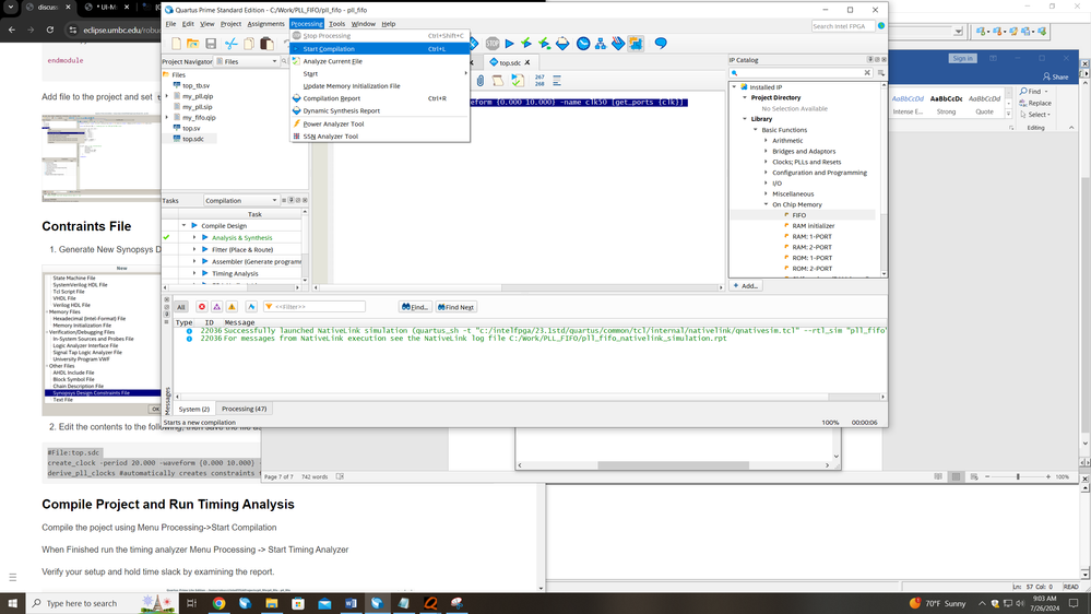

  • Compile the Project
    1. Compile the project by selecting Processing -> Start Compilation

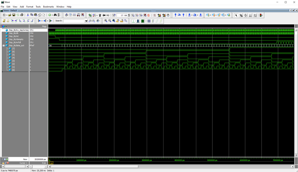

  1. Add signals into the waveform by running the following command:
add wave -position insertpoint sim:/top_tb/*
(The /* after your directory will add all signals from that file to the waveform)
  1. Finally type the following command to run the simulation:
run -all
  1. The simulation is now complete and will be shown in the waveform window
