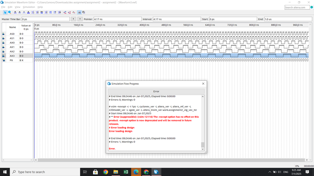

SIMMULATION ERROR
I face a question to do the simulation. This is what i got from the simulation report.
I checked the file assignment.do but i cannot access. I deleted the novopt part in the simulation setting.

**** Running the ModelSim simulation ****
C:/intelFPGA_lite/20.1/modelsim_ase/win32aloem/vsim -c -do assignment2.do
Reading pref.tcl
# 2020.1
# do assignment2.do
# ** Warning: (vlib-34) Library already exists at "work".
# Model Technology ModelSim - Intel FPGA Edition vlog 2020.1 Compiler 2020.02 Feb 28 2020
# Start time: 09:26:27 on Jan 07,2025
# vlog -work work assignment2.vo
# -- Compiling module assignment2
# Top level modules:
# assignment2
# End time: 09:26:27 on Jan 07,2025, Elapsed time: 0:00:00
# Errors: 0, Warnings: 0
# vlog -work work Waveform3.vwf.vt
# -- Compiling module assignment2_vlg_vec_tst
# assignment2_vlg_vec_tst
# Executing ONERROR command at macro ./assignment2.do line 5
Error.
1 Reply
- ShengN_altera
Check this link https://community.intel.com/t5/Programmable-Devices/Error-The-novopt-option-has-no-effect-on-this-product/m-p/1444877
If make the above change, can simulate but no output waveform, try to use older device like MAX II because this is legacy simulator main for legacy devices.
Sheng
