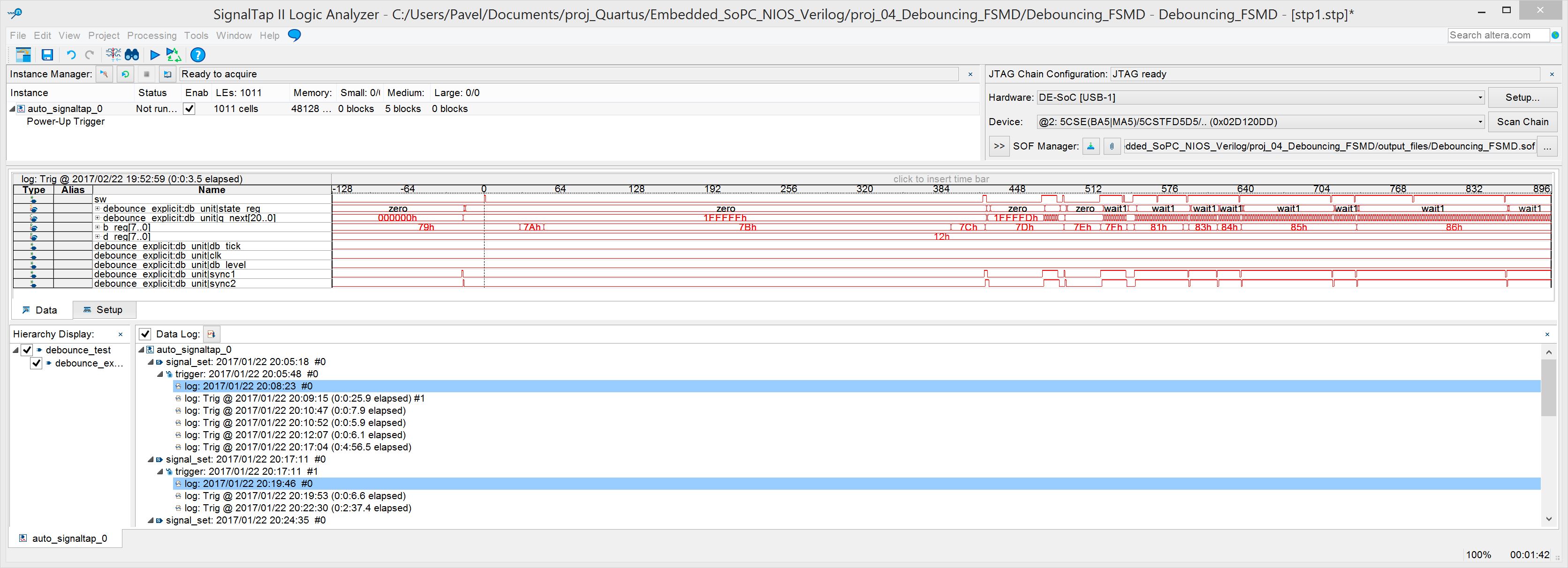

And here is SignalTap simulation
http://www.alteraforum.com/forum/attachment.php?attachmentid=13218&stc=1
After 2st firing of the input sw the "state machine" frozes definitely in "00" state.
Moreover, after 1st sw firing, the "state machine" value is displayed in symbolic interpretation in SignalTap II, i.e. zero, wait0, one, wait1.
After 2nd sw firing this symbolic interpretation disappears ... leaving place to numeric interpretation, i.e. 0 (as shown on the above image).
So I have 2 questions:
  • why symbolic interpretation disappears
  • is it possible to put into SignalTap the signals that present in the source code in order to debug "system machine" misbehavior. Actually only few signals are available for SignalTap.
Thanks in advance

  • Altera_Forum's avatar
    Altera_Forum
    Finally, Synchronization Register Chains resolved the problem.
    I applied 2 flip-flops to sw input:
    	reg sw1, sw2;
    	DFF sync1 (.d(sw), .clk(clk), .clrn(1'b1), .prn(1'b1), .q(sw1));
    	DFF sync2 (.d(sw1), .clk(clk), .clrn(1'b1), .prn(1'b1), .q(sw2));
    and then applied sw2 to state machine (instead of sw).
    However the signals sw1 and sw2 aren't accessible in signaltap ... only sync1, sync2.
    I suppose that sync1 and sync2 are actually sw1 and sw2 ?
    https://www.alteraforum.com/forum/attachment.php?attachmentid=13260
