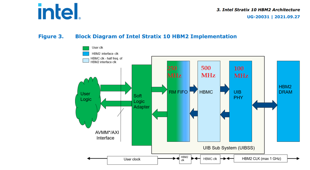

I am getting Setup Time violations on HBMC clock Domain (500MHz) due to Long Routing paths.
Type : Setup 'hbm_top_inst|iopll_t|iopll_t_outclk0'
Slack : -1.109
TNS : -863.275
Corner: Slow 900mV 100C Model
Type : Setup 'hbm_bottom_inst|iopll_b|iopll_b_outclk0'
Slack : -1.021
TNS : -1141.048
Corner: 1 Slow vid1 100C Model
Could you please suggest a fix for this issue?

May I know is the timing violation fail in our Intel IP or in the design?

Setup Time Violation is in Intel IP (Quartus generated HBM IP)

Following our discussion offline, problem has been root caused: HBMC IP & Quartus tool version mismatch
