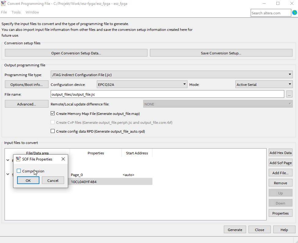

      Hello, this is noch working for me. I'm still not able to encrypt programming files. This Option is not available. This should be in the new window when clicking on "properties".
      I am using Quartus Prime 17.1 Lite Edition.
      In AN 556: Using the Design Security Features in Intel FPGAs on page 12:
      "Note: To enable the design security feature for Intel Quartus Prime Lite Edition, obtain a
      license file from Intel FPGA Technical Support."
