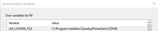

Thank you rostaman whatever you went through to get through the LM_LICENSE_FILE environment variable problem would be helpful.

Hey RFI, I finally got it working! Before I only had the path to the subdirectory for my LM_LICENSE_FILE. I changed that to be the fully qualified filename of the license file. It still didn't work with the change to only the System environment variable, but after I modified the User one too, BOOM! Success!
Hope it works for you too, friend.- RFI4 years ago
Thanks I am not sure what you mean by "fully qualified name" can you post a screenshot? I was only adding an env variable to User variables, I will try system variable next.
