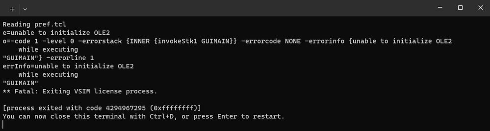

I recently generated a license for the Questa FPGA SE (Questa*-Intel® FPGA Starter Edition SW-QUESTA) for Quartus Prime Lite edition. I am running into issues when attempting to start the Questa simulation software.

Issue:
When running Questa, I run into this error.
From the error, I understand that this is a licensing issue, but I am confused where to go from here..
I would appreciate any guidance from the forum. I hope to have informed well.
