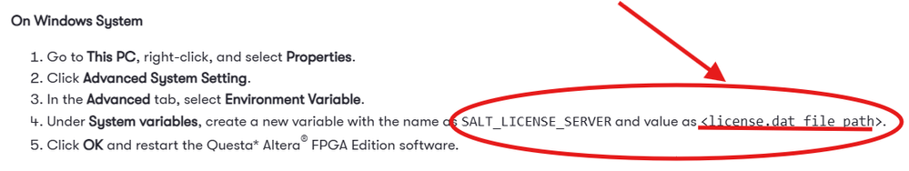

I got a new work PC (WIndows 11) recently, so I downloaded Quartus Prime Lite 25.1. At the time, I also included Questa Altera Edition in the download. But I didn't try to use Questa. Last week, ...

5 months agoYou have to point to the specific file in the environment variable SALT_LICENSE_SERVER, not the folder where the file is located..

Thanks sstrell and ShengN. That was the problem, I just had the path, but not the actual filename there. The instructions from the SSLC are not clear in this regard. They just say to that the system variable value is the file path. There is no mention of also including the actual license filename.
