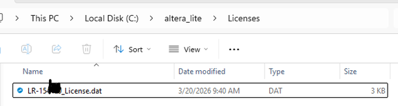

The system variable SALT_LICENSE_SERVER has a value of C:\altera_lite\Licenses. (This is a folder I made to put the license into.)
This folder contains one file called LR-154xxx_License.dat (LR-144xxx is the name of my computer).

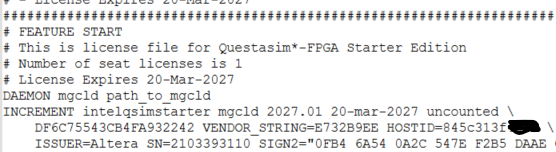

The contents of the LR-154xxx_License.dat file has correct MAC address. Here are some snips from the file.
This block is repeated with the same HOSTID, a different Altera SN, and different codes.
