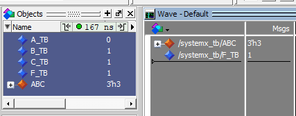

3 years agoQUESTA - When simulating, a number appears followed by " 'h " in the bar
Hello, I am using the Quartus Prime Lite Questa simulator (version 22.1). When simulating, in the "objects" bar as in "Wave - Default - Msgs" a number appears followed by " 'h ": for example in obje...
- 3 years ago
Right-click the signal and adjust the radix. 3'h3 means a 3-bit wide signal with hex value of 3, which would be the same as 3'b011.
