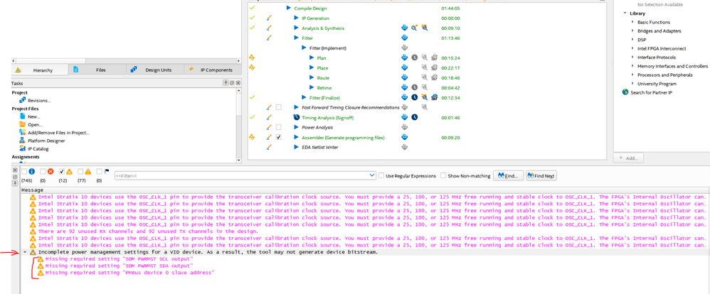

While compiling my Stratix 10 design using Q23,1 I got the following Critical Warning:
Critical Warning(19238): Incomplete power management settings for a VID device. As a result, the tool may not generate device bitstream.
Critical Warning(19239): Missing required setting "SDM PWRMGT SCL output"
Critical Warning(19239): Missing required setting "SDM PWRMGT SDA output"
Critical Warning(19239): Missing required setting "PMBus device 0 slave address"
What causes this ? How can it be fixed ?
Hi there,
You need to set this setting in Quartus->Assignment->Device->Device and Pin option->(Configuration->Configuration pin options)/(Power managements ). According to your schematic and power vr.
- WZ2
Hi there,
- FvM
