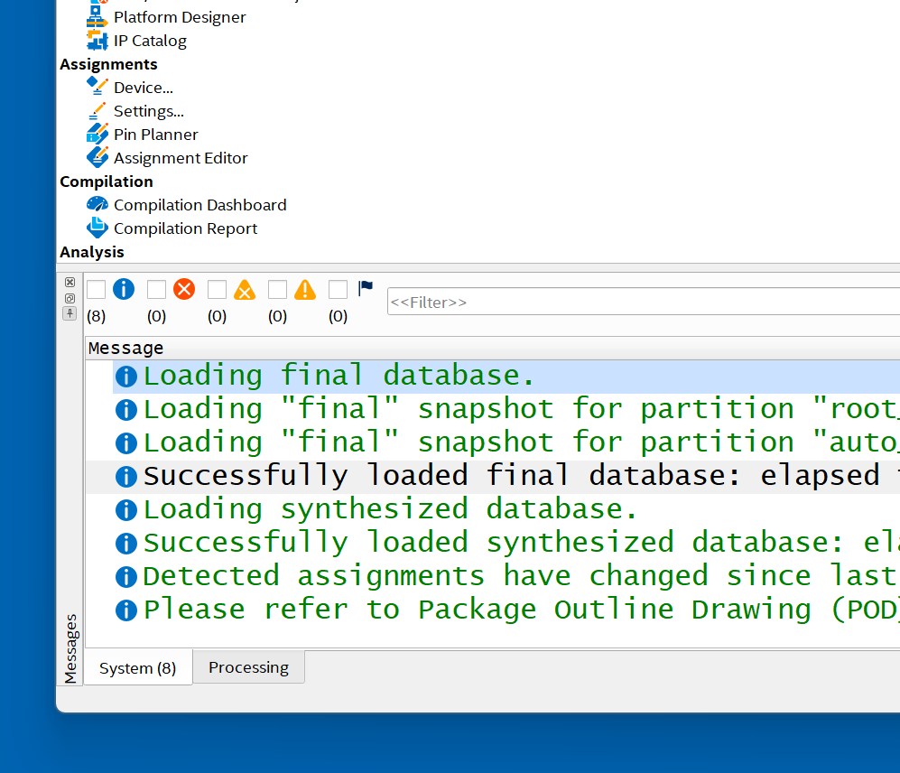

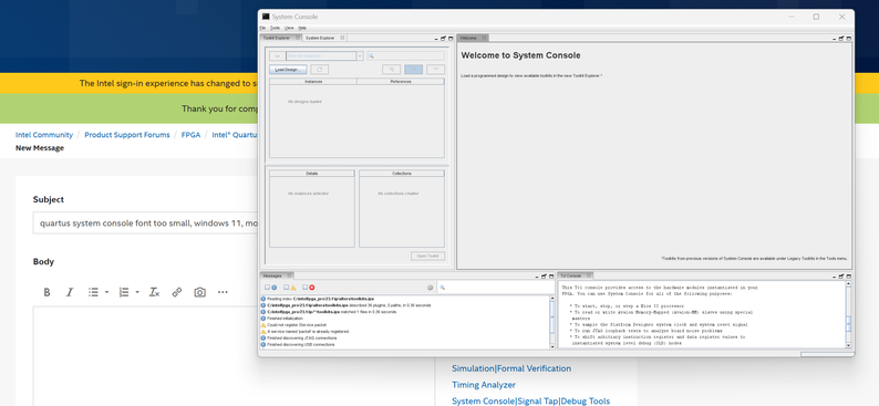

quartus system console font too small, windows 11, monitors 2496 / 1664
What is up with Quartus , using lates, on W11 ,
see in screen shot atatched,
the text in the background, is a web browser, quiet happy with windows resolution, font is very readable, whilst Quartus , seems to be hard fixed for a resolution of around 1920 by 1220
Is there a setting one has to fiddle with to make the console readable ?
or do I have to drop back 20 to a lower resolution monitor ?

      • MauricioM's avatar
        MauricioM
        Hi John!
        I had the same Issue, I solved it going to the install folder, in my case: "intelFPGA_pro\22.2\syscon\bin"
        Next doing the instructions on the following link for the file "system-console.exe":
        https://www.thewindowsclub.com/how-to-change-scaling-for-specific-apps-in-windows-11?expand_article=1
        I used System (Enhanced) on the last options, after that you can open the system-console from quartus or what I'm going to do is also create a shortcut from here so it's a little faster than opening quartus and then system console.
        Hope this helps.
        Mauricio

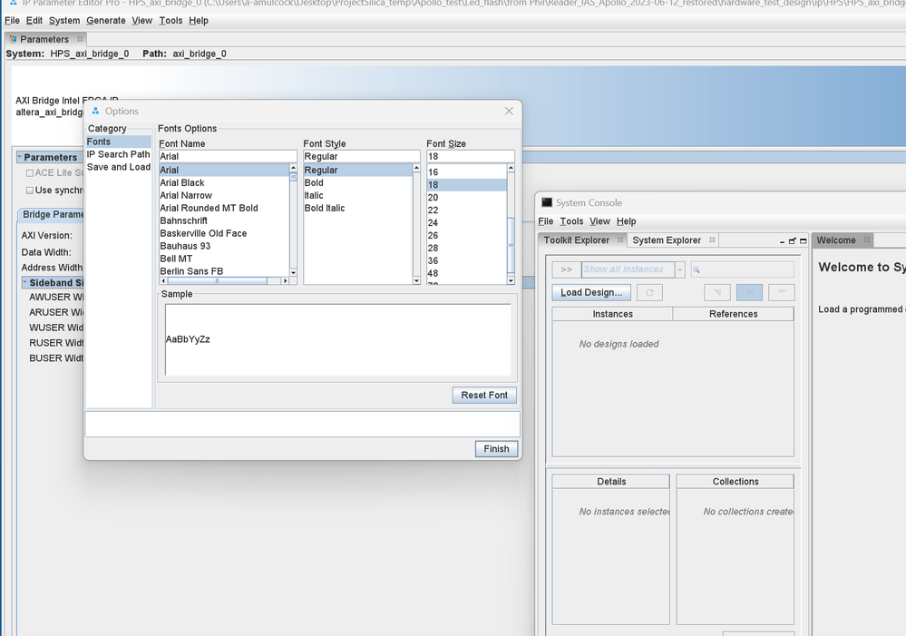

  • drjohnsmith's avatar
    drjohnsmith
    One step forward,
    under tools options in the IP parameter editor , I found this ,
    so It seems I have to set font size in each tool. depending if Im working on the big screen or the laptop screen !
    Uhm, unusual..
