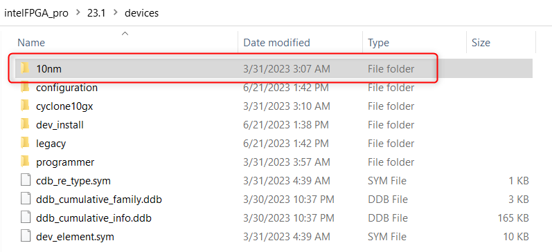

I installed device file agilex7-23.1.0.115.qdz of Agilex by using dev_install.exe.
Its name in directory C:\intelFPGA_pro\23.1\devices is 10nm.
I am using Quartus Prime Pro v23.1.

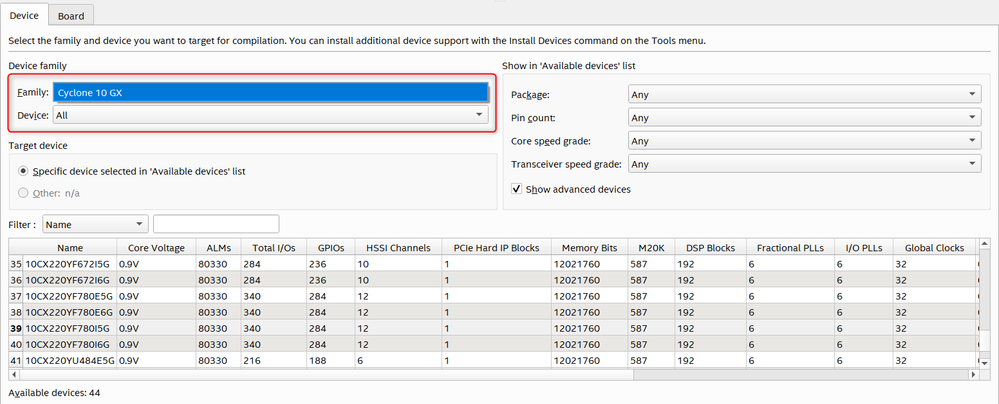

When creating a new project, device family of Agilex can't be found.
Why can't I see device family of Agilex in the catalogue?
