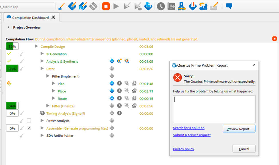

Quartus Prime pro reported error during full Compilation
My environment: Quartus Prime Pro 22.4, 10as016E4
Today I instantiated PLL in my design, then I clicked the “start compilation” button, then below error windows popped.
After I clicked the “cancel” button, the interface changed as below. You can see the fitter actually completed when the error occurred.
I also clicked the “review report” button and copied the error log as below FYI.

After the error reported, if I try the timing analysis by “ctrl + shift + T”, the process can be started separately and completed successfully. And then I started the Assembler separately by clicking the “Processing->Start->Start Assembler”, this step can also be completed without error.
If I deleted the PLL instance from my design, this error window will not appear after I click the “start compilation”, all steps will be completed.
