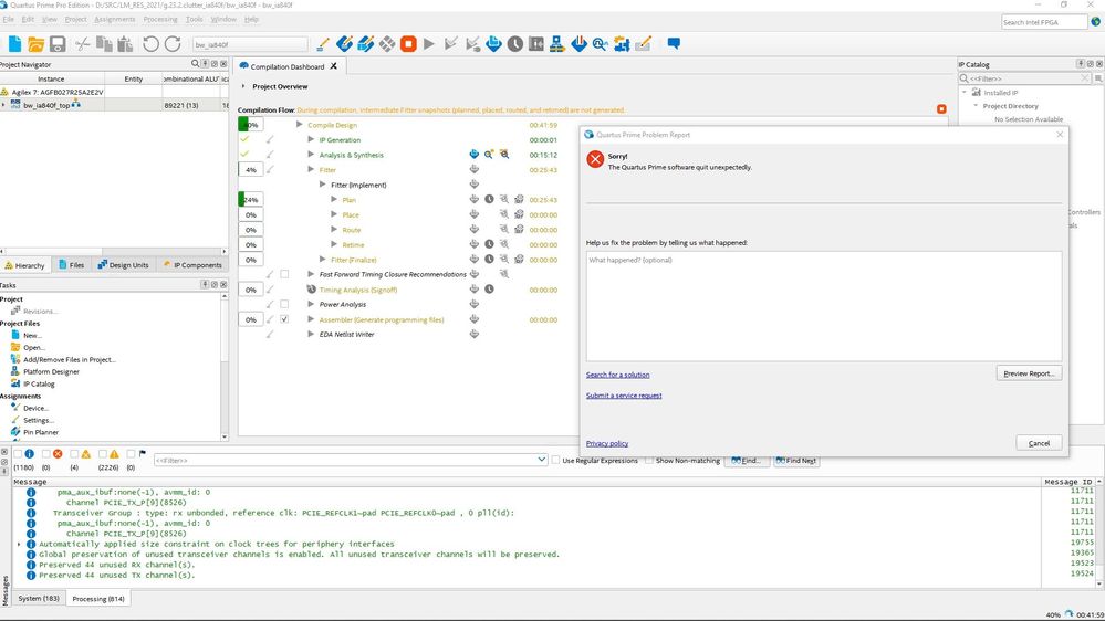

I first saw this error for Agilex designs under Prime Pro 22.4 and also 23.2. It is repeatable and seem related to signaltap. My signaltap nodes are all pre-synthesis, and previously I 'cured' the problem by deleting the latest signaltap changes and adding them again. Now after several design changes and signaltap additions it is happening again. I think I see which nodes it's complaining about and will try to adjust those. The questionable node(s) shouldn't be available for selection in signaltap, but also shouldn't cause a crash if they are in the .stp file.
Example error
Problem Details
Error:
Internal Error: Sub-system: PTI, File: /quartus/tsm/pti/pti_tdb_builder.cpp, Line: 5410
ATOM uut|ddr4_dram_sub|emif_fm_0|emif_fm_0|arch|arch_inst|io_tiles_wrap_inst|io_tiles_inst|tile_gen[1].tile_ctrl_inst Type: FALCONMESA_TILE_CTRL (atom id 506) with OTERM type O_MMR_OUT[33] does not lead to top-level port when it wants to reach ITERM type DATAIN[0] of ATOM uut|ddr4_dram_sub|emif_fm_0|emif_fm_0|arch|arch_inst|hmc_mmr_if_inst|mmr_slave_waitrequest_1 Type : FALCONMESA_FF (atom id 46363)

Screenshot
