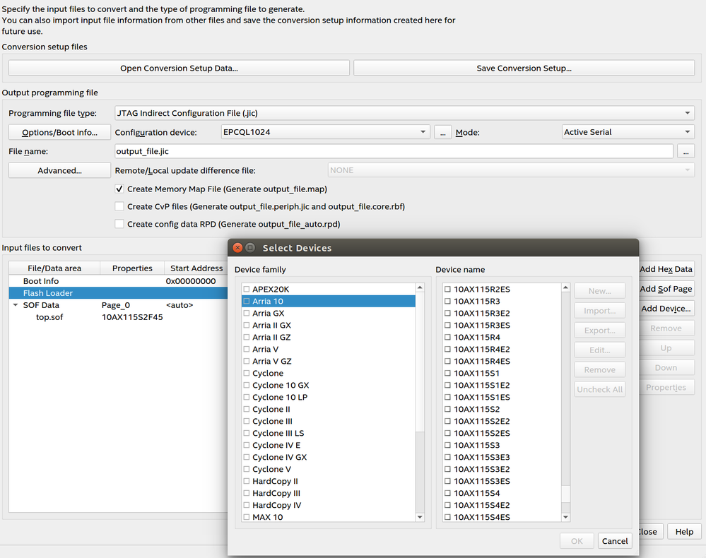

I have followed the CvP tutorial through to "Splitting the SOF file" in section 3-4. When I load my SOF Data file in, under "Properties", my device is listed as the 10AX115S2F45. The tutorial specifies I need to select the flash loader as "10AX115S1F45I1SG" - I have used the "S2" variant in my Quartus project since the User Guide specified this as the correct chip.
However, when I go to select the "Flash Loader" device, in the "Select Devices" list, I am presented with a significantly reduced set of devices than available elsewhere in Quartus. In terms of "10AX115S2" devices, I have the choice of:
  • 10AX115S2
  • 10AX115S2E2
  • 10AX115S2ES
Selecting either the "E2" or "ES" designations will cause Quartus to crash with an error report which is attached at the bottom of this post.
Selecting "10AX115S2" will successfully create the periphery and core files, however this isn't a specific designation as the tutorial suggests I should choose.

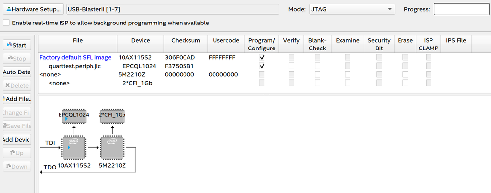

I specify my periphery image for the EPCQL2014 device, and my programmer window looks as follows:
I then hit "Start" to start flashing, the flash seems to progress, but hits 88% in the progress indicator and says "(Failed)".
In the messages console:
"Error(209025): Can't recognize silicon ID for device 1. A device's silicon ID is different from its JTAG ID. Verify that all cables are securely connected, select a different device, or check the power on the target system. Make sure the device pins are connected and configured correctly."

  • Hi,
    When you convert the sof file, you should select "10AX115S2" as this is the production device which is on your board.
    For the programming issue, may I know if you are using AS (Active Serial) configuration mode? Could you check your board MSEL to see if it is selecting AS mode? If no, please change the MSEL to AS before powering up the board.

    • RBish3's avatar
      RBish3
      Ahhh, excellent, that's sorted the problem out John. For whatever reason, the newer tutorials don't specify that you have to set the MSEL jumpers into the Active Serial mode - hadn't made the link that the files generated earlier were configured as such. The periphery image is programmed using JTAG so its relevance wasn't particularly obvious.
