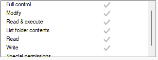

    Please do the steps below:
    1.Go to the Quartus installation path,
    2.Right‑click the folder → Properties.
    3.Go to SecurityEdit.
    4.Select your Windows user (or the Users group).
    5.Enable Modify and Write permissions. Apply to all subfolders.
    Allow full control like below screenshot:
