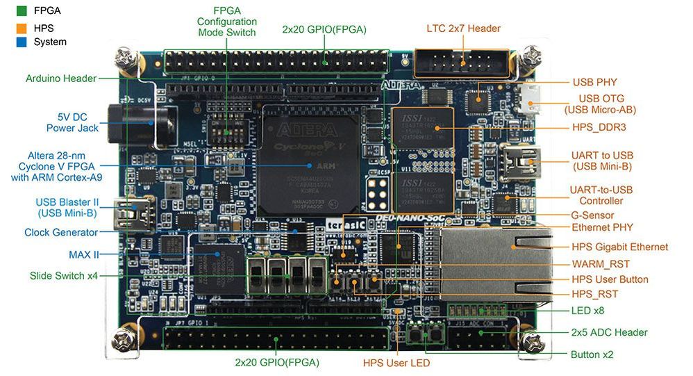

- Abe
The DE0-Nano board has 2 Micro-USb ports. one for the USB-blaster and the other for the USB UART. Make sure you are connecting to the correct USB port , power on the board and then try. Take a look at the following pic
