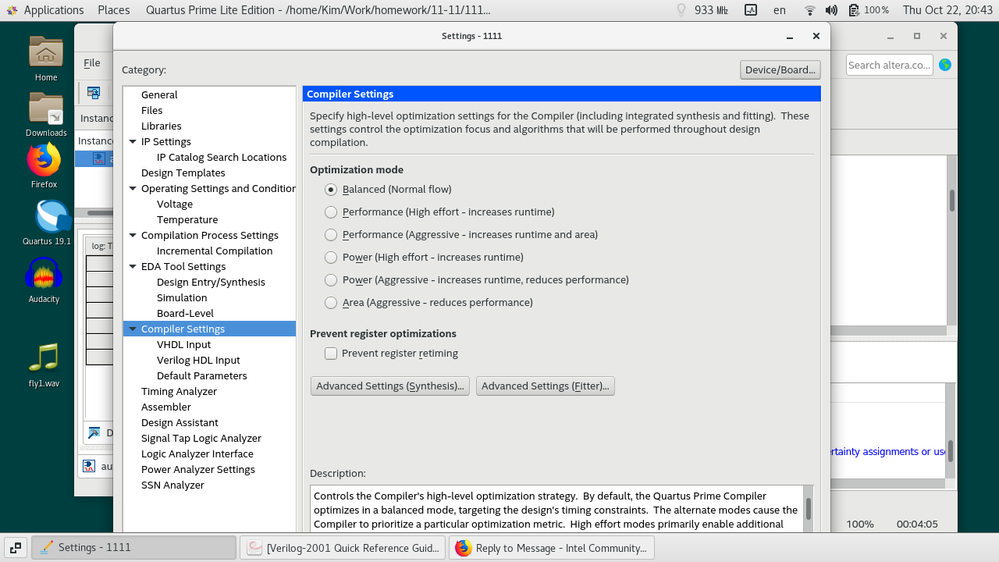

I have a laptop with 1366x768 display. Linux Centos7.
Quartus 18.1 running fine but the "Assignment" "Settings" window is too tall and I cannot move it to get to the 'Apply' or 'ok" at the bottom.
The system requirements say 1024x768 or better.
Is there a way to change this particular window size?

That just made it worse.
xrandr show just 1366x768 as the max.

My screen resolution is max'd out at 1366x768.
I need to change what Quartus thinks is the default screen resolution.
If I can't move it up or scroll down to the 'apply' box it thinks my screen is taller than it is.
Again , is there an environment variable that Quartus can read to get it right.
also ,as I said before , if the minimum screen resolution for this software is 1024x768 it should work. I have xranr to 1024x768 and that shows the window even taller than it was before.
