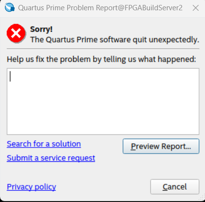

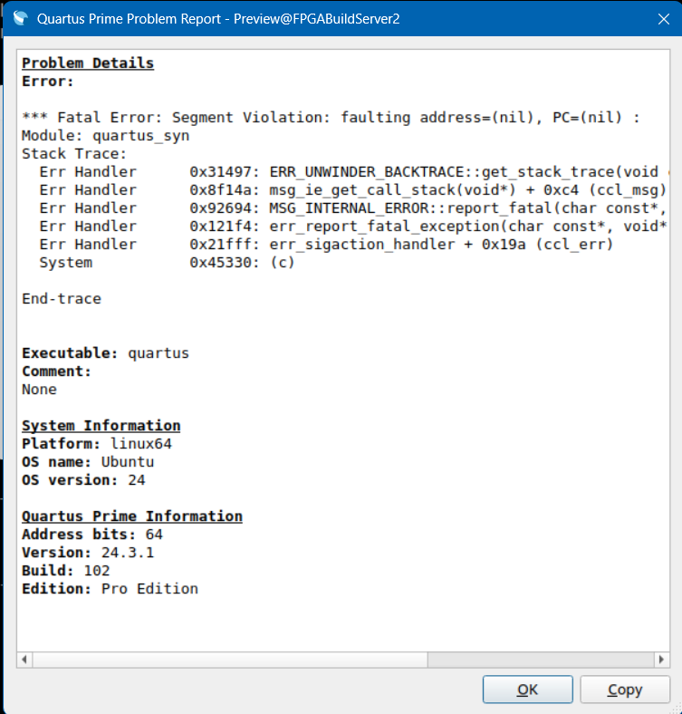

This is what I get:
And if you open "Preview Report":
See the file "Error.txt" to see the error message.
I also attached the whole build log in BuildReport.txt.
Please let me know if you need more information.
Best,
Ali
- ShengN_altera5 months ago
I can't find the database. Could you try latest version 26.1?
Could you try re-generate the jesd ip?
Could you also provide minimum project which can duplicate the issue? Else, it'll be difficult to debug
