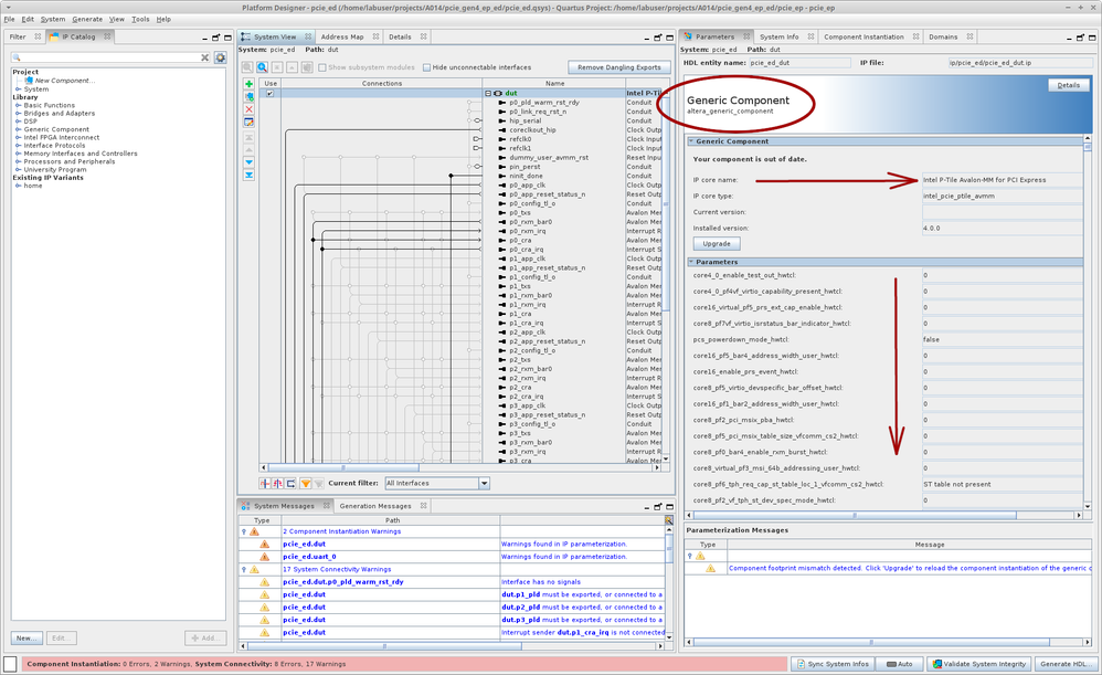

Quartus P-Tile PCIe IP config crashes
Trying to configure a basic PCIe interface on the Agilex F014 EVM, and the P-Tile IP configuration crashes if I disable either the read-data-mover or write-data-mover functions under the Avalon-MM Settings tab. Re-enabling the data-mover button leaves the configurator in a persistently confused state. Something bad is happening during core elaboration.
I don't have a streaming-data application, so the ST core isn't useful. I don't have any DMA support in my system (hence the desire to disable the data-movers.)
This issue exists in Quartus 22.3 and 22.4. We have a system with PCIe-to-Avalon-MM running on a Cyclone 10GX and it works fine. We want to have comparable functionality on our Agilex-based boards, but the P-Tile core appears to be broken. Screen shot and error log are attached.

    Allow me to clarify my upthread claim that Intel isn't using the PCIe Avalon-MM IP core in their own demo design. If you open the included demo design, you'll see that there's a "generic component" implemented, that happens to have its name assigned to that of the busted IP Core. Maybe Intel was hoping nobody would notice that they're not using their own IP ...
    The generic core has a Big List o' Parameters ... nominally 2000 of them ... unrolled as a flat-file list. The API we are looking for is the one that identifies and describes every one of these parameters such that we, the community, may community-support ourselves.
