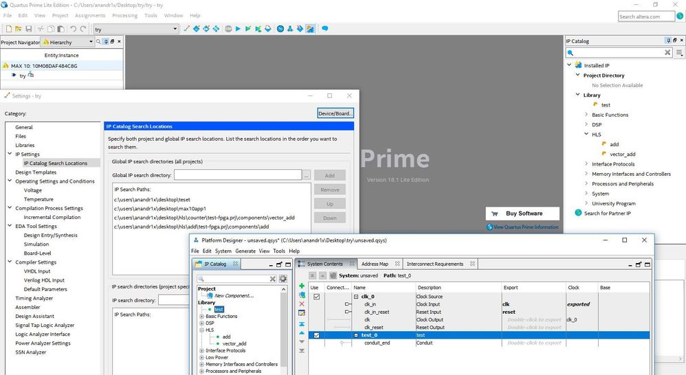

I can't replicate the scenario using Quartus 18.1 Lite.May be issue with your setup environment attached image for reference
Try installing latest Quartus Lite version.
