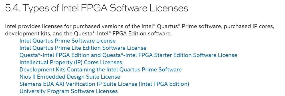

In addition, 5.4. Types of Intel FPGA Software Licenses (capture below) doesn't refer to Quartus II sofware.
So, if a Quartus prime license is compatible with Quartus II 13.0sp1, is there any document/datasheet that describes this?
And which license should I look for? A quartus prime pro or standard edition license?
Thank you again,
