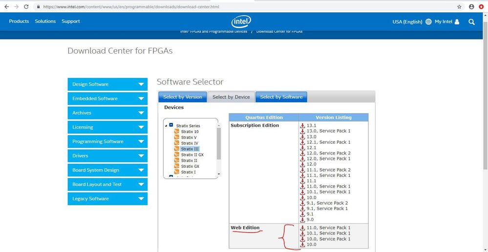

Hi Nick,
For Stratix III devices, you can use the Quartus II Web edition(versions) that don`t require the license, as shown in below,
https://www.intel.com/content/www/us/en/programmable/downloads/download-center.html
Intel also provided free Intel Quartus Prime Lite Edition and ModelSim - Intel FPGA Starter Edition software does not require a license.
For students Intel has started Intel FPGA University Program,
https://www.intel.com/content/www/us/en/programmable/support/training/university/overview.html
Vicky
