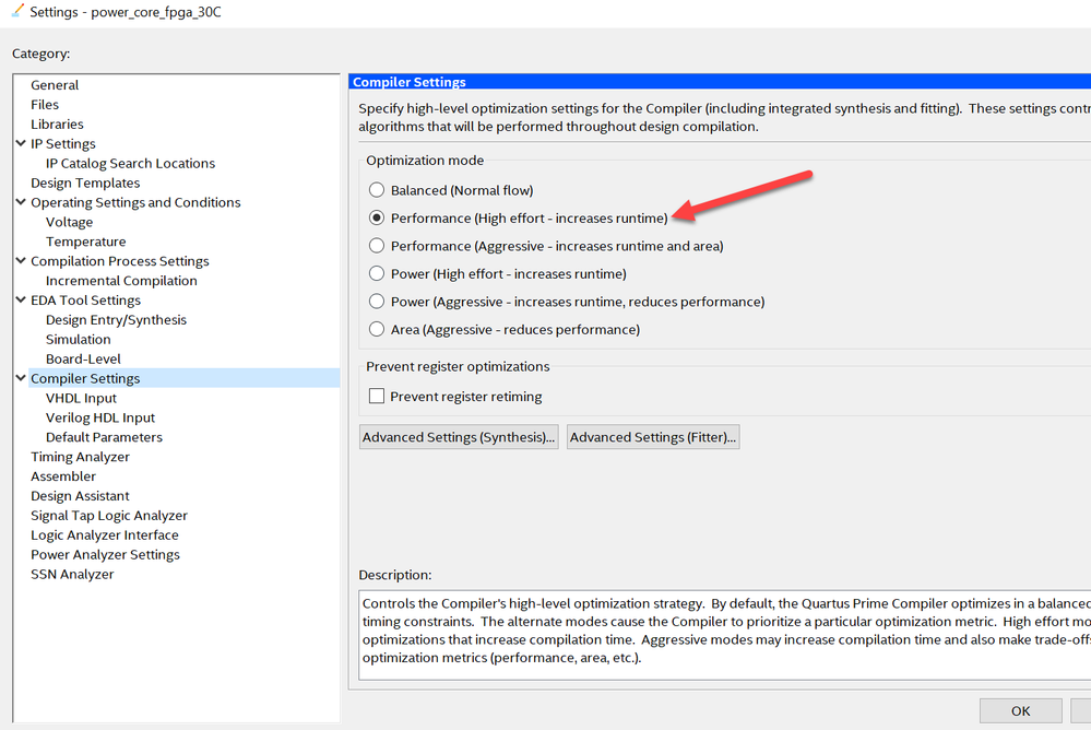

The router settings have been at Performance (High Effort) and the design compiles often.

Choosing the performance option runs the Fitter "harder" to get better results. Even with minor changes, you're changing the initial seed used by the Fitter so the results can be different (including not finding a valid fit).

Thanks for the feedback. I will try efforts other than the Performance option. Timing is not critical in this design.
