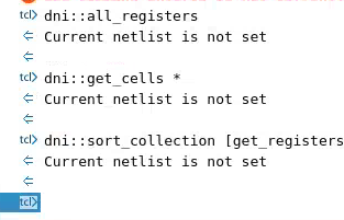

2 years agoQuartus: "Current netlist is not set" , "SDC Command entered is not currently supporte..."
While using Quartus Timing Analyzer, it seems that whenever I try to use most commands in the ::quartus::dcmd_dni tcl package, I get this message: The command does not return any other string ...
RichardT_altera
2 years agoI believe you ran those command in the Timing Analyzer GUI console.
Most of time we run sdc constraint or ::quartus::sta packages' tcl in that console.
Those commands seem usable in the Quartus GUI Tcl console, not in the separate Timing Analyzer GUI.
