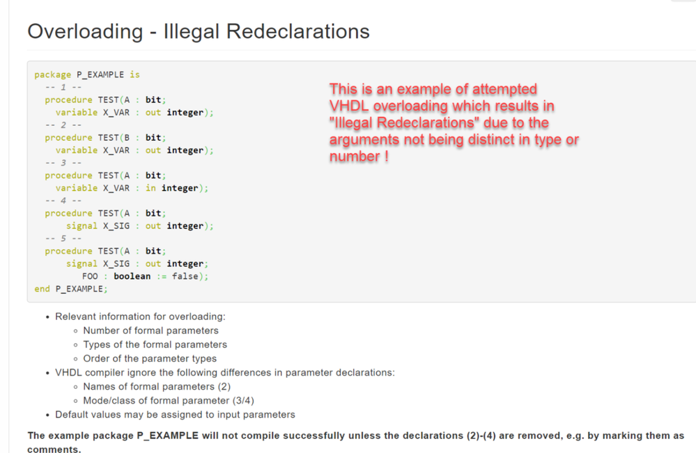

I have a question on why does Quartus allow redundant overloaded functions to be compiled without raising an error condition.
An example overloaded illegal redeclaration in a VHDL package is shown below.
So why does Quartus allow this?

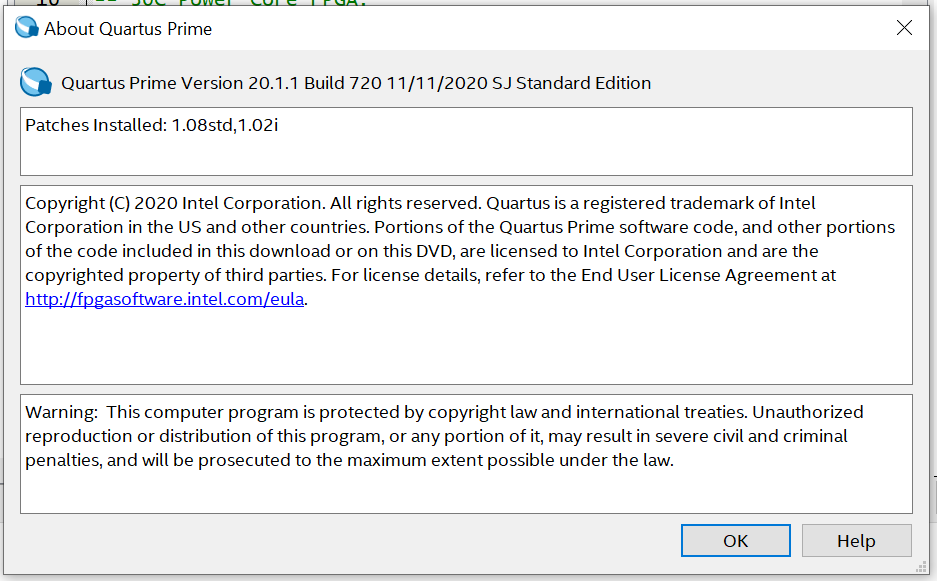

Nurina,
I am using Quartus Prime Standard Edition 20.1.1 Build 720 with Patches Installed 1.08std, 1.02i running on Windows 10 primarily but also on Ubuntu.
James
