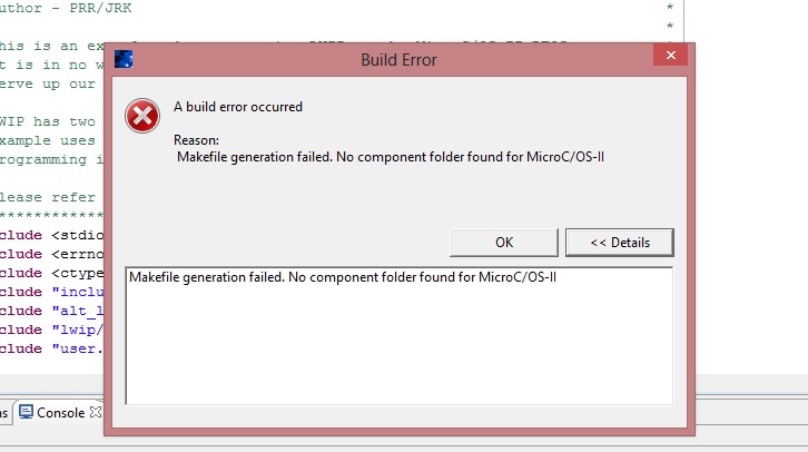

  • Altera_Forum's avatar
    Altera_Forum
    I loaded the sof file using quartus 12, and it was successful. But when I tried to run in nios II of version 6.0, it gives an error that the MicroC/OS ii component is unavailable
