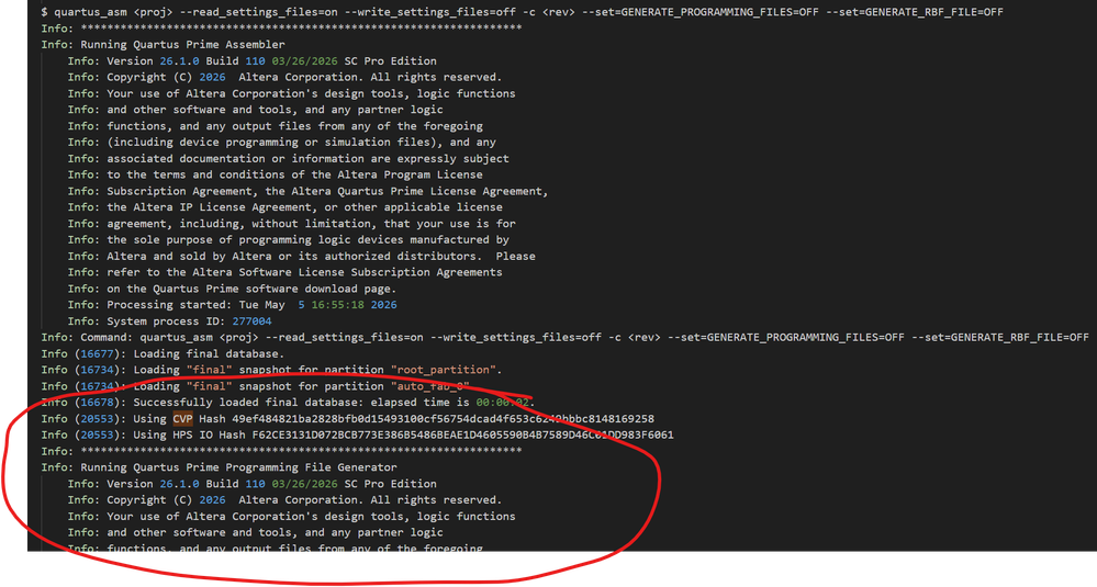

Hello Farabi,
Thank you for your response. I believe you have misunderstood my issue. I do NOT have an issue converting an sof file to an rbf file.
My issue is that running quartus_asm automatically invokes quartus_pfg. The quartus_pfg command then fails unpredictably. This causes the quartus_asm and also the entire run to return an error code.
Yes, I can re-run quartus_pfg and it eventually succeeds, but this behavior (quartus_pfg failing non-deterministically) conflicts any CI pipeling that developers might want to setup and is surely not intended.
Best,
Axel
no RBF generated so far:
- axel1922 hours ago

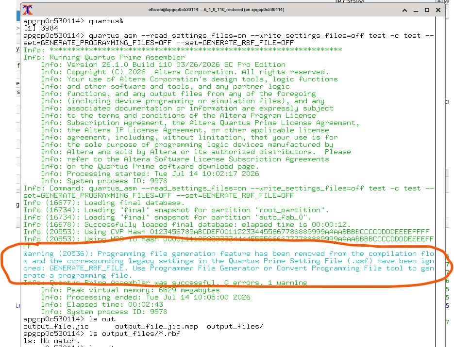

Hello Farabi,
Thank you for your response. Unfortunately, I get a different result from invoking the quartus_asm command as you can see in logs that I have provided in my initial post the Quartus Prime Programming File Generator gets invoked automatically when running quartus_asm
Thank you!
Axel
