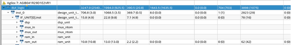

I think your project may spend lots of time to conduct optimization. Please check the hierarchy under the project navigate to see if there is any module optimized away like the following results:
- TingJiangT_Intel
Contributor
The optimization results is as the following:

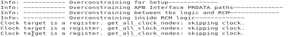

- BaluM
Thanks let me check, my run is stuck at this point for maximum time.
