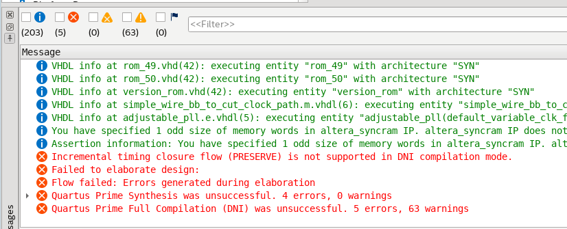

3 years agoQuartus 23.1 pro: --dni does not support preserve runs (synthesized or final)
Quartus 23.1 pro: --dni does not support preserve runs (synthesized or final), timing analyzer.
Is it planned to add the support?
- RichardT_altera
As of now, there are no plans to support this feature.
To resolve the error, you will need to remove both the PARTITION and PRESERVE assignments from your project's setting file (.qsf)
