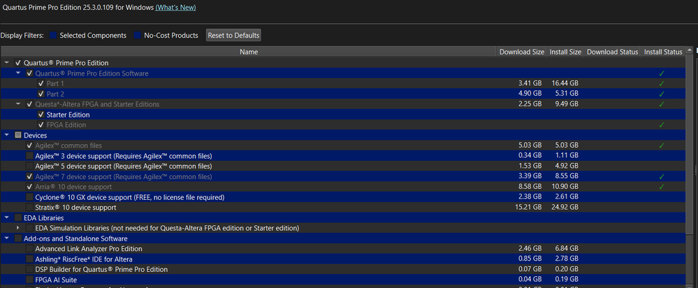

I just install the Quartus 25.3 with below selected and using a 30 day evaluation license, it still works fine from my side.
I suggest to uninstall the Quartus and reinstall it from clean.Install this patch as well: Why do I unexpectedly observe intermittent DDM Errors? | Altera Community
